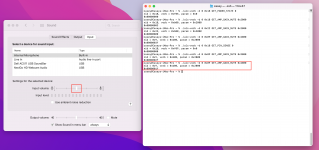

Some intermediate findings:
  • Before sound can be input or output, it's necessary for at least 4 parameters to be set properly:
    • Power State -- state 0 means fully powered up
    • Pin Sense -- determine if anything is connected to an audio jack -- should be 0x80000000 if something is connected, 0x0 otherwise
    • Input Enable -- on all input jacks, the Input Enable bit must be set to 1
    • Amplifier Gain and Mute -- gain (volume) setting must be non-zero and mute bit must be off (set to 0)
  • For a microphone, let's consider this path map consisting of 3 "widgets" (yes, that's the correct term):
    • Pin (audio jack) 0x18
    • Mixer 0x22
    • Audio Input 0x09
  • Every widget along the path must:
    • ... be fully powered up
    • ... not be in mute state
  • The Pin widget (0x18) should have gain of 0x01 or 0x02 or 0x03
  • The Pin widget (0x18) should also have pin sense high (0x80000000)
  • The Pin widget (0x18) should also have Input Enable bit set to 1
  • The Audio Input widget (0x09) is where the input volume is actually adjusted, so its Gain setting can vary from 0x00 to 0x3F (for this motherboard)
In the screenshots below we can see nearly all of the above. We can also see that moving the Volume slider in System Preferences --> Sound --> Input changes the Gain setting on the Audio Input node (0x09) from 0x3F down to 0x00.
Case 1: Input Volume at maximum. We can see Gain of node 0x9 also at maximum 0x3F:

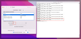

Case 2: Input Volume at 75%. We can see Gain of node 0x9 also at 75% of maximum or 0x2F:

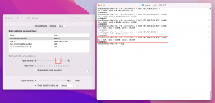

Case 3: Input Volume at 50%. We can see Gain of node 0x9 also at 50% of maximum or 0x1F:

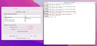

Case 4: Input Volume at 0%. We can see Gain of node 0x9 also at 0% or 0x00:

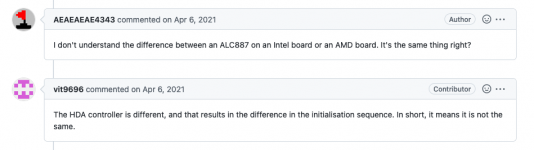

Continuation of Previous Post:
  • There are two parts to any High Definition Audio (HDA) implementation:
    • The controller
    • The codec
  • All audio processing takes place within the codec
    • The codec is the ‘sound card’
  • The codec is independent of the system bus, which means the same codec (sound card) can be mated to a PCI bus or a USB bus, etc.
  • If it’s mated to a PCI bus, there is a PCI controller associated with the codec
  • The PCI controller interfaces the codec with the PCI bus, which means it provides configuration space registers, configures and controls DMA, configures and controls interrupts, configures and controls PCI capabilities, etc.
  • The codec itself implements a bus-independent command and control interface through “verbs”
    • In English, a verb is any word that indicates an action, an occurrence or a state of being
    • Codec verbs also indicate an action to be taken (a command), an occurrence (does a particular capability or connection exist), and a state of being (current state or status of any particular node)
  • If we look at IOReg of an Intel board containing PCI audio (not USB) we will see and HDEF parent device and below that an IOHDACodecDevice:
    • The controller HDEF -- Vendor ID 0x8086 (Intel)
    • The codec IOHDACodecDevice -- generally Vendor ID 0x10EC (Realtek)
  • Common controllers on AMD are:
    • Vendor ID 0x1022 (AMD)
    • Device ID 0x1457 or 0x1487 or 0x15E3
  • On an AMD board, audio output works properly, but not audio input (microphone and Line In)
  • The codec, however, appears to be set up and controlled properly as the previous post shows
  • So if only the input fails, where might the problem lie? Some possibilities include:
    1. Starting and stopping the audio input stream
    2. Setting up or accessing the input stream DMA buffers (each stream requires its own DMA buffer)
    3. Interrupts not being triggered on input stream
    4.
 other
  • In other words, the problem may lie somewhere in the AppleHDAController kext, which interfaces with the controller
