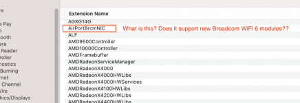

Yes it exists inside of IO80211PCIFamilyLegacy, but I'm wondering why it was moved out of there and placed directly into /System/Library/Extensions as its own parent-level driver...
I thought we were looking at /System/Library/Extensions, but instead the screenshot is from System Information --> Extensions. So actually there's nothing new.
