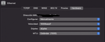

Have you tried switching to Manual and changing it to 1000 Mbps or 2500 Mbps?
....only 100mb
