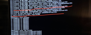

Might be an ACPI problem, the other Gigabyte user needed 2 ACPI patches + an SSDT, I'll check their DSDT once I get home.Just woke up so I’ll look at SysReport soon. Right now my suspicion is on incorrect device EC and a bunch of other ACPI table load failures.
10 tables failed to load.
Yes please flash the latest BIOS using BIOS Flashback if your motherboard supports it. The DSDT is corrupted -- maciASL is unable to open it. The various ACPI table load errors also point to a faulty DSDT.@mariettosun I think the bios is junk I'm trying to flash it again... no USB is recognized in the Q Flash
It's corrupted from Gigabyte, the other user had the same issue. You need to hex patch _PRW from GPP7 to XPRW and UP00 from GPP7 to UPXX. Then you should be able to decompile it.Yes please flash the latest BIOS using BIOS Flashback if your motherboard supports it. The DSDT is corrupted -- maciASL is unable to open it. The various ACPI table load errors also point to a faulty DSDT.

You're absolutely right. Those two patches allow DSDT to load!It's corrupted from Gigabyte, the other user had the same issue. You need to hex patch _PRW from GPP7 to XPRW and UP00 from GPP7 to UPXX. Then you should be able to decompile it.
They also need an SSDT to disable the UPXX device we renamed to.@ManuelB
All of the changes are in the attached EFI. Please try this EFI folder as-is with no changes.

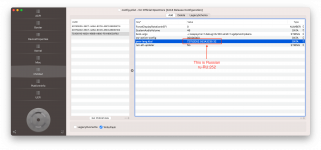

Congratulations! Let us know when it's installed, as we need to optimize your MmioWhitelist (as many set to True as possible).@CaseySJ @mariettosun @ExtremeXT I was able to boot it for the first time, it's Russian, but it doesn't matter, I'm trying to install it. Patching isn't my forte, but I think it's very important here. You all have enormous knowledge and without it it doesn't work. You are probably aware that without you there is almost no Hackintosh anymore!!! I would like to thank you from the bottom of my heart that was and is a fantastic support for me and for everyone else here.
Wonderful -- that's more like it!!@CaseySJ @mariettosun @ExtremeXT I was able to boot it for the first time, it's Russian, but it doesn't matter, I'm trying to install it. Patching isn't my forte, but I think it's very important here. You all have enormous knowledge and without it it doesn't work. You are probably aware that without you there is almost no Hackintosh anymore!!! I would like to thank you from the bottom of my heart that was and is a fantastic support for me and for everyone else here.
), but we can change that easily:
