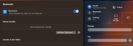

wifi geht bei mir nur 2,4 Ghz er hat Aktuell schwierigkeiten andere netze zu finden siehe Bild.
BT ist wichtiger da ich dadrĂ¼ber Audio höre da könnte ich eure Hilfe gebrauchen

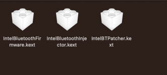

@ExtremeXT I just installed the 3 texts after that I have no more signal on the monitor

no, I haven't done anything yet, apart from downloading the two, I would now add the USBtoolbox.kext..... and what should I do then
Remove UTBDefault and make UTBMap with the USBToolBox tool.

sorry no Picture. I just installed the kexte as you said and added them to Opencore, but it starts up but has no picture anymore..I'm trying to rebuild and delete one after the other

sorry @ExtremeXT sorry i missed post 127 that was the mistake... now i come back to ventura but BT still doesn't work

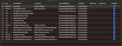

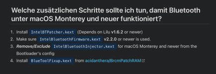

Remove IntelBluetoothInjector and get BlueToolFixup.
@ExtremeXT i did now it finds my airpods max but its totally full of glitches/stutters
@ExtremeXT I've tested it now, it's only every now and then very slight dropouts ... maybe there will be something better in the future I'm looking for a BT dongle that supports Mac
