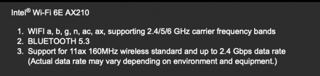

What can we do to make BT and WiFi work
Intel wifi 6E AX210

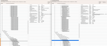

about audio:
@ManuelB motherboard has:
  1. Realtek® ALC1220-VB CODEC
    * The back panel line out jack supports DSD audio.
  2. Support for DTS:X® Ultra
  3. High Definition Audio
  4. 2/4/5.1/7.1-channel output
    * You can change the functionality of an audio jack using the audio software. To configure
    7.1-channel audio, access the audio software for audio settings.
  5. Support for S/PDIF Out
so it is the same USB audio I have
no need of applealc kext
and his IOREG should be pretty similar to this:
left is my audio right Gigabyte x670 (Internal audio)

post your ioreg or try to boot your system without audio jack connection (disconnected from board or case) and see if you see
Post also this page if you like
Intel wifi 6E AX210
You need:
  • AirportItlwm
  • IntelBluetoothFirmware
  • IntelBTPatcher
  • BlueToolFixup
  • USBToolBox
  • UTBMap (map with USBToolBox from Windows)
about audio:
View attachment 8367View attachment 8368
ALC1220-VB is normal audio, not USB.

my error to read another user ioreg
sorry!
