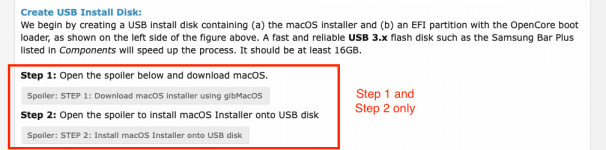

1,269
@CaseySJ Many thanks for the EFi and your support, but I can only get as far as can be seen in the picture
Do you have a valid USB install disk? Please see Steps 1 and 2 only from this guide:
Also please use the new config.plist attached below.
