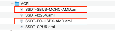

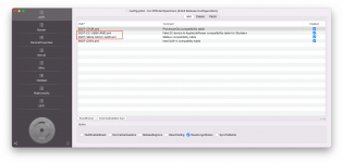

@ManuelB,
I recommend changing the file names of these two SSDTs:
  • Change SSDT-EC-USBX.aml to SSDT-EC-USBX-AMD.aml and rename the file in Finder
  • Change SSDT-SBUS-MCHC.aml to SSDT-SBUS-MCHC-AMD.aml and rename the file in Finder
This will allow HackinDROM to upgrade OpenCore for you in the future. If you need help with HackinDROM, just ask.

@ManuelB,
View attachment 8703View attachment 8704
Does it use that to check if it's an AMD system? Can't that be done with the detection of the kernel patches?
