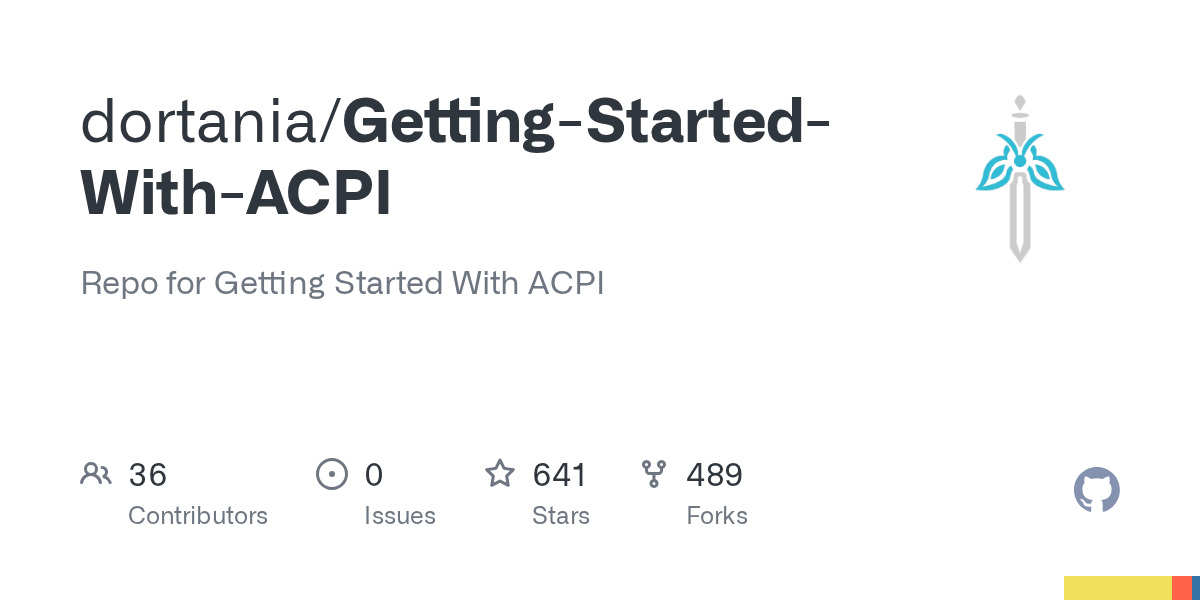

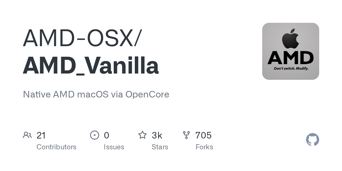

Rolls eyes!... Anyway here we are, with the little information you have provided, other than your CPU is 6 cores, I ended with this, attached below.
1. Oof, your patches were light years out of date. fixed that.
2. I left your SMBIOS blank, I suggest iMacPro1,1 IMO!, and experience, it would just be better suited to someone of your experience.
3. PlatformInfo > Generic > ProcessorType > Number > 1537 to match your 6 core CPU. For 8 Core and above its... 3841.

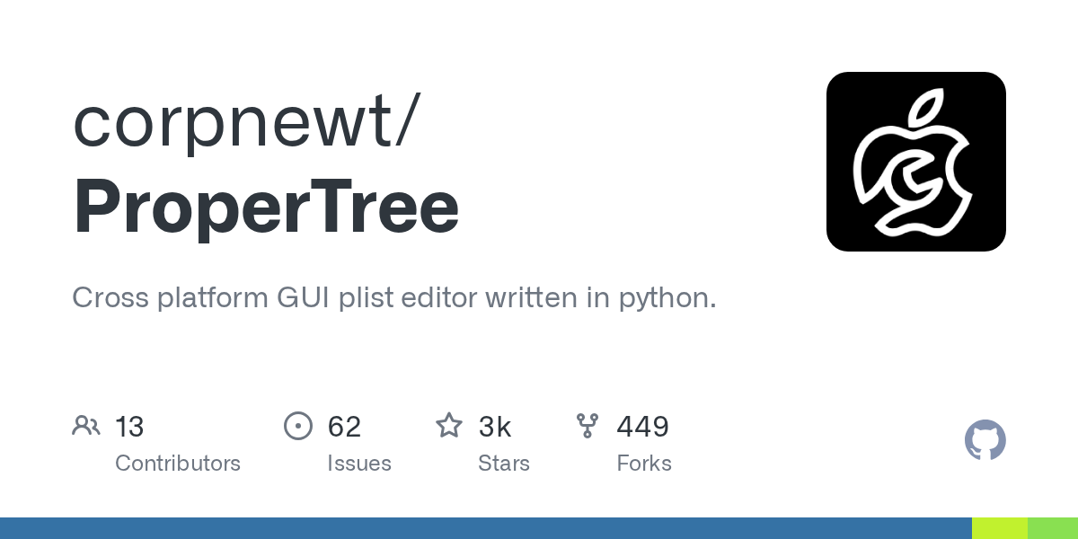

4. You will need to add SSDT-CPUR to your EFI > OC > Kexts folder, Snapshot in Propertree and BOOM, your done.
5. I think I forgot something!.
