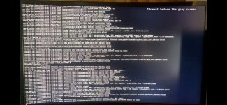

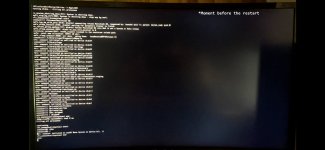

Hi!
I really need your help! I have been struggling with installing MacOS Sonoma to my computer using OpenCore bootloader. I'm not really new to this, I did some work before, and i had a working Ventura on my PC as well. Now I want to upgrade to Sonoma, so i downloaded the recovery of it. I made an installer from the begining for it, downloaded all the updated Kexts, my Bios, the OpenCore(0.9.5) and so on. I booted the installer and it started to load the system, but after it a grey screen appeard, an error showed and it simply restarted. I catched the moment before the restart with camera, and it showed: "IOPlatformHaltRestartAction -> Apple SMC" (I'll link the picture). I can't really find a solution, I have struggling with it for 2 whole day. I will link my config.plist to this comment as well as the moment before the grey screen appeared and the moment before the restart.
I hope we can find a solution!
Thanks for your help!!

Post a copy of your whole OC EFI folder, as the config.plist doesn’t tell the whole story about your OC setup.
After updating the Bios, did you reset the Bios so your system will work with macOS?

OK, your OC EFI doesn't look bad, but there are a couple of issues that aren't right.
  1. First, is your use of iMac20,1 SMBIOS in a system that lacks an APU/IGPU.
    • The iMac SMBIOS is only meant for use when an integrated GPU is present.
    • This is not the case in your system, you have a discrete GPU with no APU present.
    • So you should be using either the iMacPro1,1 or MacPro7,1 SMBIOS.
  2. Second, is your USBMap.kext is not correct for your Gigabyte 570X motherboard.
    • You have 7 x ports set as Type-C, when your motherboard doesn't contain a single Type-C port or motherboard header.
    • These 7 x ports are spread between the XHC1 and _SB.PCI0.BXBR.BYUP.BYD8.XHC0 USB controllers.
      • 4 x ports should be set as USB3 (3) not Type-c+sw (9),
      • 3 x ports should be set as Internal (255).
Your motherboard has the following USB ports available.
Integrated in the CPU:
  1. 4 x USB 3.2 Gen 1 ports on the back panel (8 x ports total)
Chipset:
  1. 4 x USB 3.2 Gen 1 ports available through the internal USB headers (8 x ports total)
  2. 6 x USB 2.0/1.1 ports (2 ports on the back panel, 4 ports available through the internal USB headers) (6 x ports total)
When setting your USB ports you need to follow this line of thought.
  1. Any port served from a USB3 physical or USB3 motherboard header should be set with the connector type USB3 (3), including the USB2 virtual ports.
  2. Any physical USB2 port (Black Tang on the back panel) should be set with connector type USB2 (0).
  3. Any port served from a USB2 motherboard header should be set with connector type 'Internal' (255), not USB2 (0) and definitely not Type-C+SW (9).
Your USBMap.kext should contain the following ports:
  • 16 x ports set with connector type USB3 (3)
  • 2 x ports set with connector type USB2 (0)
  • 4 x ports set with connector type Internal (255)
  • 0 x ports set with connector type Type-c+sw (9)
Your USBMap.kext is missing one port from the _SB.PCI0.BXBR.BYUP.BYD8.XHC0 Usb controller - port SS03. This is fine if you are not using it.
Another issue is that your USBMap.kext is set for use with a system that uses the MacPro7,1 SMBIOS, not the iMac20,1 that is currently in your config.plist. So the kext won't work with your current setup.
Fixing these issues may give you a better chance of booting macOS Sonoma.
I would also suggest you add the ResetNvramEntry.efi driver to your /EFI/OC/Drivers folder and your config.plist. As you will need to use it before you boot with your revised OC setup, using the MacPro7,1 SMBIOS.
To use this Driver once you have added it to your OC setup, simply press the Spacebar while on the OC boot screen. This will unhide the Tools and drivers present in your OC setup, among which should be the ResetNvramEntry.efi icon.
This will simply wipe all existing NVRAM entries and automatically reboot the system. So when it next boots it uses the NVRAM entries in your revised setup, not the old and possibly incorrect settings.

Thank you for your answer!
I did what you wrote, except the USBMap.kext because I couldn't deal with it, so I just deleted it (I think it's not a big problem, because I used Ventura without USBMapping for a long time and it was good to go). So I rewrote the SMBIOS values, added ResetNvramEntry.efi to the config and booted it up again. But I have the same issue as before.
I also tried to boot it up in safe mode from the OC Bootloader, but it booted into a circle with line through it(I will link the picture from it). I will link my updated EFI folder as well.
Thank you, for your help! Appreciated!

Still not sure what is causing the issue but here is a cleaned up and slightly revised EFI folder for you to try.
Thank you!!
I tried it and it booted up so much faster to the Bootloader than mine, but I still have the same issue as before.
But I guess I found the problem. I tried to download the recovery of Sonoma (BaseSystem.dmg, BaseSystem.chunklist) with OpenCore’s “macrecovery” with this command: py macrecovery.py -b Mac-27AD2F918AE68F61 -m 00000000000000000 download. I don’t know if it is right, I just found it on the internet, because on the official site, there was no command for it. And I guess it downloaded a recovery of another MacOS version.
If thats the problem, can you link a command for it, or can you suggest me a method to download it?
