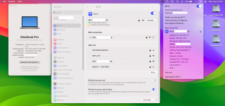

With only changing the MaxVersion on the kernel patches and updating Lilu macOS Sonoma works just fine :D
Edit: I don't recommend updating your current system with Sonoma. If you want to test it use a different drive/partition.
You've set all the patches to 23.99.99 which is incorrect. See the GitHub for the correct way. They've been updated.

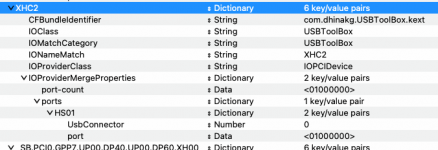

You have a couple of issues in your setup as I see things.
Most important is the failure to add the CPU core Replace entries for your CPU. You don't have any entry for your 16-core CPU in the replace fields in the first four kernel patches.
Screenshot 2023-06-24 at 23.39.18.png No details for the CPU core count!
Your UTBMap is attempting to activate 17 x USB ports under two different USB controllers. This is wrong.
There is a maximum of 15 ports per controller, which you are exceeding with the _SB.PCI0.GPP7.UP00.DP40.UP00.DP60.XH00 and _SB.PCI0.GPP7.UP00.DP60.XH00 USB controllers.
The XHC0, XHC1 and XHC2 USB controllers are fine, as they only look to activate a maximum of 4 ports at most.
Does your motherboard support 43 USB ports?
As that is what you are showing and looking to activate in your UTBMap.kext/Contents/Info.plist.
Screenshot 2023-06-24 at 23.49.36.png XHC0 USB controller - 4 x USB ports
Screenshot 2023-06-24 at 23.49.51.png XHC1 USB controller - 4 x USB ports
Screenshot 2023-06-24 at 23.50.03.png XHC2 USB controller - 1 x USB ports
Screenshot 2023-06-24 at 23.50.21.png _SB.PCI0.GPP7.UP00.DP40.UP00.DP60.XH00 controller - 17 x USB ports
Screenshot 2023-06-24 at 23.50.35.png _SB.PCI0.GPP7.UP00.DP60.XH00 controller - 17 x USB ports
Fix these Items and you should be OK.

thank you very much for your help that worked enter the core count...I must have overlooked entering it again during all the tests...I didn't know about the USB....I will create a new USBmap.kext and then put it here again upload.
