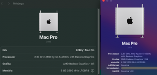

I also installed it on my laptop. (Acer Swift 3 AMD4500U) "Nootedred.kext"

@BCBoy1 you might want to look at increasing the amount of memory available to the AMD graphics in your Acer Swift 3 laptop. As 512MB is low. I think NootedRed recommends a minimum of 1GB.
Unfortunately, it cannot be set in the settings.
Thus, only 512 MB memory is available.

That is one pared down bios.
You can use Smokeless UMAF to unlock the option.
AMD CBS > NBIO Common Settings > GFX Configuration.
Reactions: Edhawk and BCBoy1
Thanks!
I managed to set it up.
