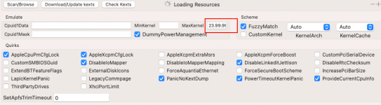

2. Set Max Kernel as 23.29.29 (This was wrong type, in EFI, it is 23.99.99)

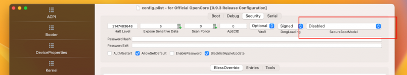

Try changing the Max Kernel to 23.99.99, disable NVMeFix.kext and set Misc > Security > Secure Boot to disabled.
Hi @Steve901,

I successfully managed to install Sonoma on my PC. (Main issue was the Max Kernel in CPU path )

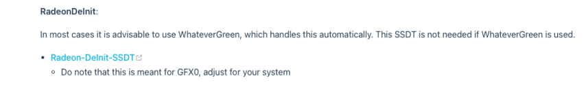

Well in that case the RadeonDeinit SSDT is there should you need it, under the Dortania Clover to Opencore conversion guide.
Unfortunately that SSDT.aml did not fix RX-560's blank screen issue at all.
So up to now I can boot by Clover 5151/5154 only without this blank screen issue.

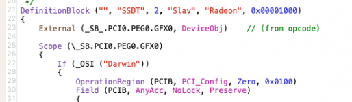

Did you edit the SSDT-Radeon-Deinit.dsl table and then compile the table to create a SSDT-Radeon-Deinit.aml table that matches the ACPI address for your RX560? As using the SSDT in its default format won't necessarily match and work with your system.
This is the default ACPI address/path used in the SSDT.
Does this match with your GPU's ACPI address/path? Check in IORegistryExplorer or on the Hackintool > PCIe devices tab to see which ACPI address/path your GPU uses.
Reactions: jsl2020
