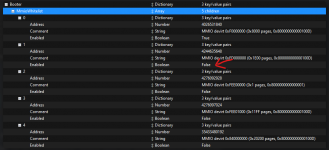

Now I activate the following, right? and so with the 5... is it correct?
Yes, if it doesn't boot whitelist that one (first one in this case) and unwhitelist the next one.
well, I have been activating one by one, with the first 4 activated ( true) it always ends in this Panic ( NVMe ? )
number 5 must be deactivated otherwise it does not pass the pre-boot
Yeah that is an NVMe panic, what NVMe drive(s) are inside the computer? Try disabling NVMeFix.
