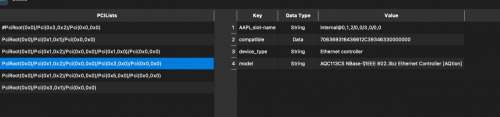

ok thank you! I'm trying to figure out how to make it work on big sur. I buy Asus ProArt x570 with this AQC113CS NBase-T/IEEE 802.3bz Ethernet Controller [AQtion] - ID:0x94c0
I tried the quirk and nothing. I tried also to add this in DP this but nothing:
any idea?
1,269
any idea?
Hello @Vorshim92
AQC-113 is not supported in Big Sur. Here's a reference table:
DeviceBig SurMonterey and Ventura
AQC-107YesYes
AQC-113NoYes
