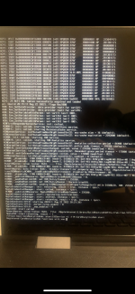

Yes i make installer with a virtual machin macos and the createvirtualmedia command.
But i can't boot on the installer, the log file isn't complet, here is the photo of the display when i'm stuck

Okay I've had a look at your DSDT. Try replacing the SSDT-CPUR.aml in your current EFI with this one. You'll need to unzip it first.

Thank you for your answer but i'm sorry to tell you that didn't worked, here is the opencore debug log

Okay. Try with this new EFI.
If it doesn't boot you must run the RESETNVRAM or Shutdown tool first before rebooting the EFI. That will clear the previous EFI cache.
