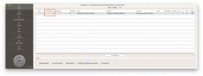

What happens if we leave TableSignature empty? Does this mean the patch was not applied?
Probably yes, we'll see when last efi test 🤷
In your previous EFI, TableSignature is correct:
But it is empty in this EFI:
Reactions: Lorys89
Not working as Casey suspected. Odd thing is that I opened the confi.plist the Table Signature is already there (as DSDT), not empty ( #82 EFI).

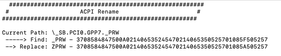

@jubarim please try form this efi :)
@CaseySJ
I used the gigabyte patched dsdt sent by you, where the _prw method is already renamed to xprw and so it just finds the name _prw and renames it to zprw
do you think it can work?
@CaseySJ
Are you trying to rename both method and name? The DSDT opens in MaciASL if either one of those is renamed.
