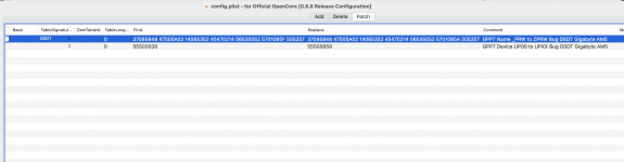

MaciASL gives an error message and doesn't open:
ok try this and if boot open maciasl and send system dsdt
EFI post #105
iASL returned:
Firmware Error (ACPI): Failure creating named object [\_SB.PCI0.GPP7.UPXX], AE_ALREADY_EXISTS (20200925/dswload-495)
Could not parse ACPI tables, AE_ALREADY_EXISTS
File appears to be binary: found 45023 non-ASCII characters, disassembling
Binary file appears to be a valid ACPI table, disassembling
Input file iASLoPnZXs.aml, Length 0x2FF89 (196489) bytes
ACPI: DSDT 0x0000000000000000 02FF89 (v02 ALASKA A M I 01072009 INTL 20200717)
Pass 1 parse of [DSDT]
ACPI Error: AE_ALREADY_EXISTS, During name lookup/catalog (20200925/psobject-372)
In MaciASL we should save DSDT in “.dsl” format instead of “.aml”. The former is un-compiled and the latter is compiled. Compiling will generate errors.A similar error occurred, see bellow.

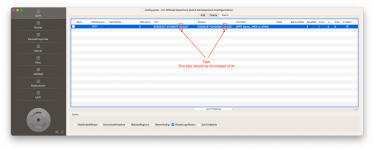

The "Name _PRW" patch didn't work in that EFI because of this typo:try this @jubarim
They don't have the byte as 00, but 50 as said correct.This patch is applied on ACPI -> Patch instead of ACPI -> Add.Hi @CaseySJ and @Lorys89 ,

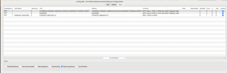

Lorys posted this config.plist acpi patches (both are enabled, I couldn't make it fit on the screen):
View attachment 10135They don't have the byte as 00, but 50 as said correct.

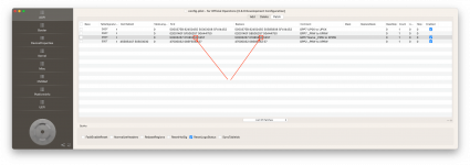

The ACPI patches are simply entered in ACPI -> Add section of OpenCore Configurator. The screenshot in your previous post already shows the patches. Both of those patches should be enabled.Ok, I will take some time studying the ACPI dortania guide this weekend, try to figure this out.
I just tried to add the patch:The ACPI patches are simply entered in ACPI -> Add section of OpenCore Configurator. The screenshot in your previous post already shows the patches. Both of those patches should be enabled.
If your system boots and works properly with just those two patches, then you're all set.

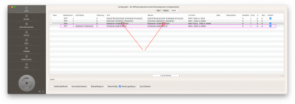

However, the patch in magenta box below should also be added to your configuration otherwise one of the standard system SSDTs will not load:
The details of this patch are as follows:
- TableSignature: SSDT
- OemTableId: 45585447 50503030
- Find: 47505032 085F5052 57
- Replace: 47505032 08585052 57
- Comment: GPP2 _PRW to XPRW
- Count: 1
- Enabled: True
