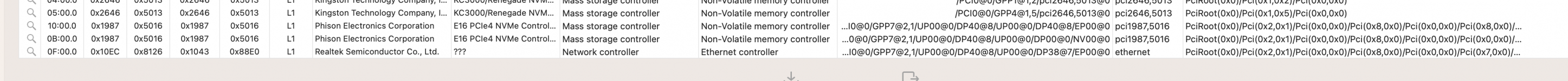

@CaseySJ this is probably the problem that some users could have in Tahoe (i think it is related in some amd kernel patches not working well in some system (i repeat because for some people there are no problems)
i think problem is there with more complex system (more than one NVME and multiple pcie fullfilled
Reactions: CaseySJ

problem happens only in Tahoe
System is perfect from Monterey to Sequoia
in tahoe i can install (and then) boot only disabling from motherboard bios my realtek 5gbit ethernet (which is unsupported from OSX but it doesnt create any problem in any OS i used also if it stays enabled in bios)
Tahoe is not stable at all and sometime it freezes after login
to have the hope to only have in ioreg i have to disable Realtek ethernet..but maybe in this way cant be useful as debug...
edit:
added realtek device picture in OSx Ventura
attached also Ventura ioreg
Reactions: CaseySJ
