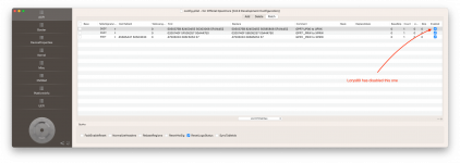

The patch has already been applied, and looks like this:

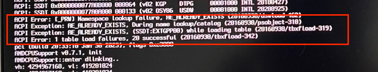

Also try the latest one attached to this post. This version includes an ACPI patch to fix this problem:
The result is the same ACPI error.

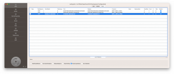

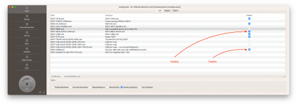

We can disable the first ACPI patch:

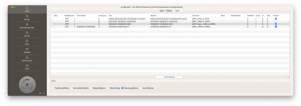

And disable these:
The attached config.plist includes these changes.

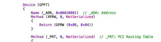

Do you show me method gpp7 pwr as it is on dsdt? I want to understand why you have to use the rename, thanks
By the way, thanks in advance for all the help until now... I could not do any of this without your help.
Let me do the next tries and post you the results.
The original and patched DSDTs are attached. The original does not even open in MaciASL!
Does the patched version have the original or modified gpp7 pwr methods?
Patched version has two changes:
  • GPP7 UP00 -> renamed -> UPXX
  • GPP7 _PRW -> renamed -> XPRW
DSDT will not open in MaciASL until both of these renames are applied.

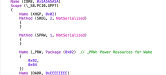

the rename is apply to method, i prefer is apply to name, and you?
Reactions: ExtremeXT
the real bug is the name _prw not the method _prw
Good observation! Yes, the real issue is Name (_PRW..). This patch fixes it:
  • Find: 53505257 01085F50 5257
  • Replace: 53505257 01085850 5257
  • Comment: GPP7 Name _PRW to XPRW
These are the 3 patches we should use, although patch 1 seems optional. We cannot open the DSDT in MaciASL unless patches 1 and 2, or 1 and 3 are applied.
