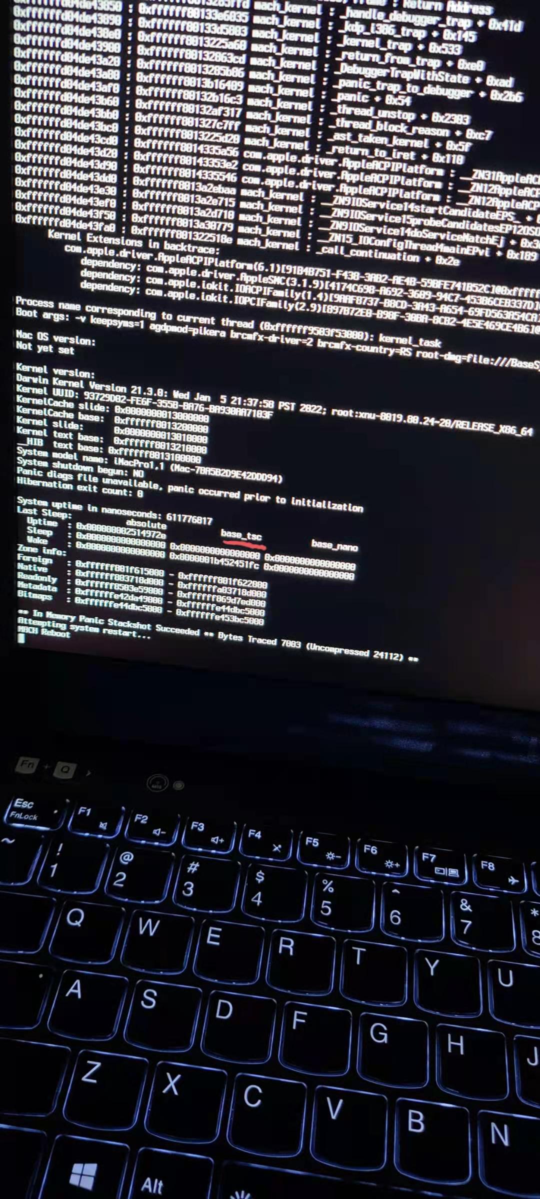

I start system large probability will stuck in the 'AppleNVMe Assert failed:',Probably my Samsung 970EVO hard drive is causing this problem,I can only forcibly shut down and restart many times can enter the system,
I found that using GenericUSBXHCI kext can normal boot system, but the USB will fail.
You can try to cancel GenericUSBXHCI Kext to see whether it is normal to start, if it is normal that you can use the installation method of writing USB disk image.

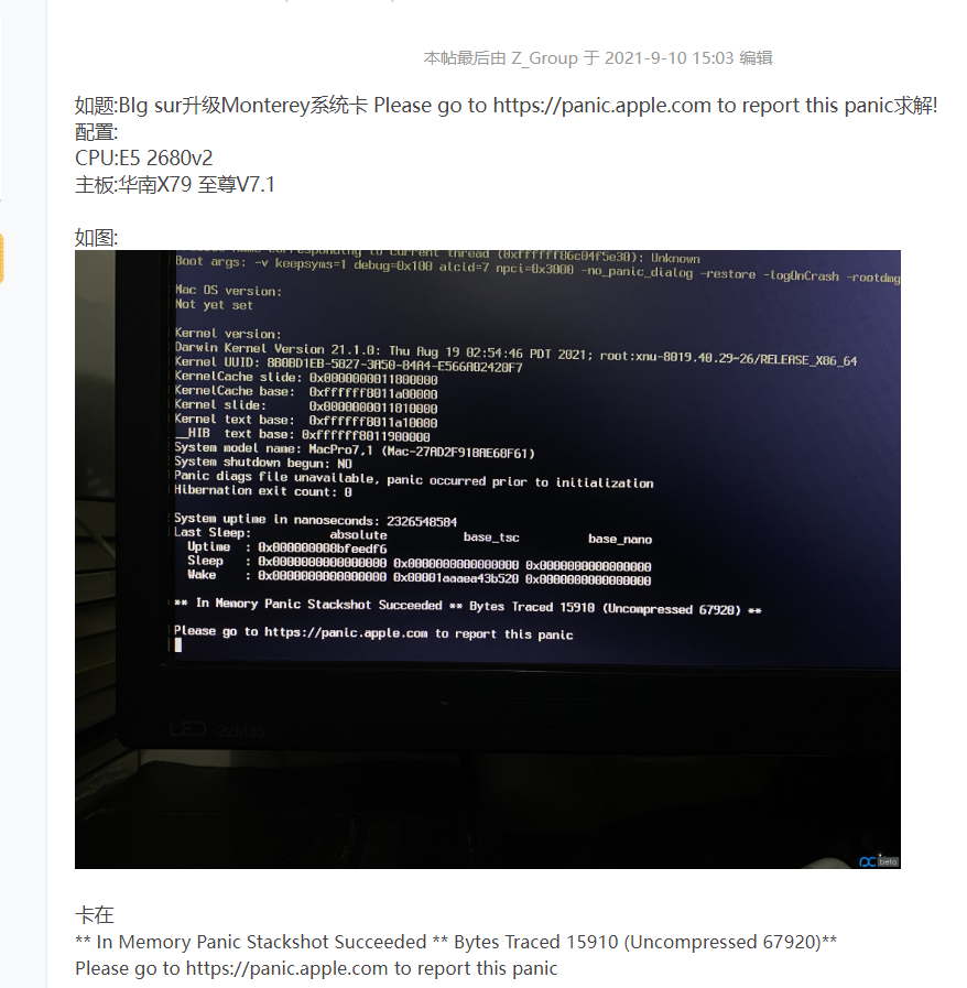

Monterey started asking for TSC_ADJUST support, so some X79 and X99 cannot be upgraded to Monterey,Legion 5 unfortunately has the same problem, hopefully OpenCore team will add this feature in the future, may need UEFI firmware to simulate TSC_ADJUST, Let the hardware support
