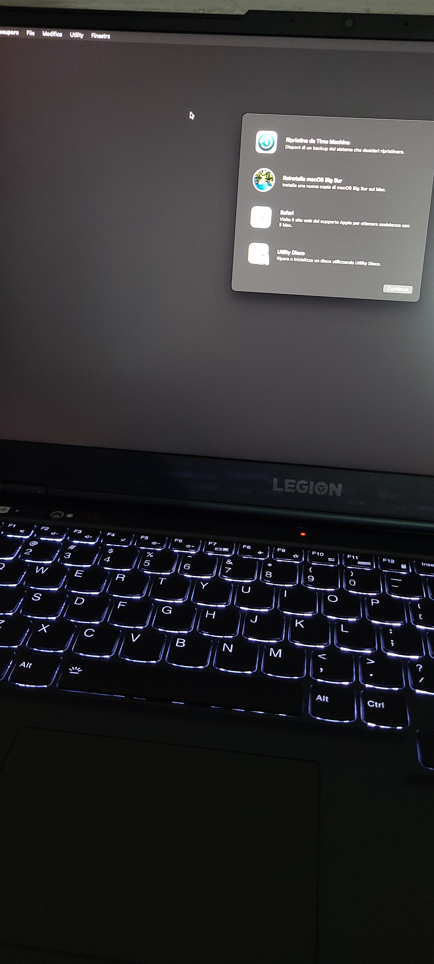

Yes, my OC configuration KEXT is all selected. You can enter the Big Sur installation screen. But most cases stop at the following code. You can only force the restart to try more times. Also, the Big Sur installation screen is slow to respond. The mouse can only move slowly. The graphics card has no driver. Therefore, the installation fails.

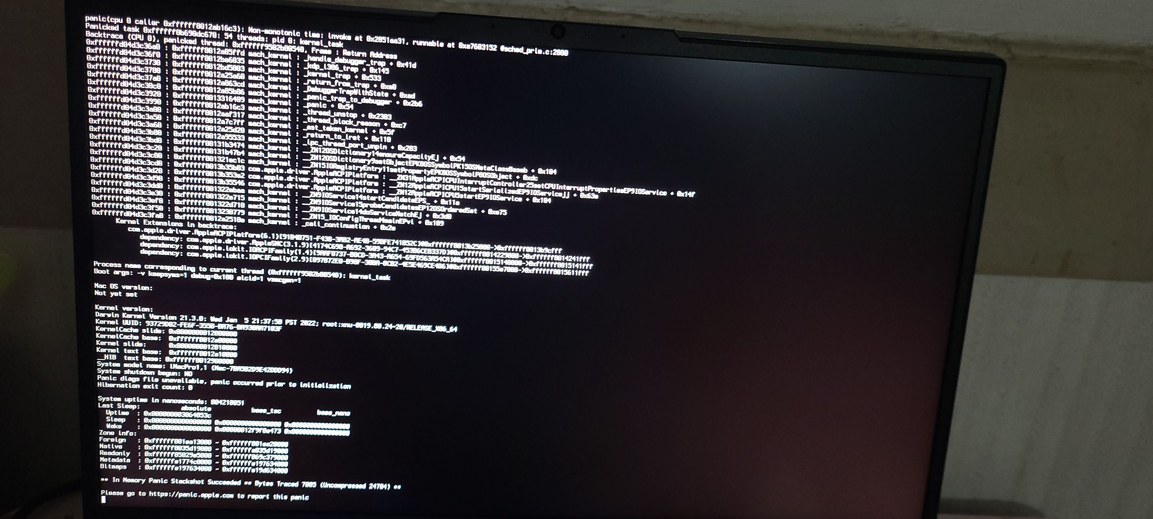

Thank you for your answer, I tried to stop at [EB LOG:EXITBS]
I want to solve the problem of installing Monterey. The test started the Big Sur installation, but failed to start Monterey.
kernel panic: AppleACPIPlatform
Installation mode: Hard disk Create 1 GB EFI partition. The com.apple.recovery.boot and OC files are placed on the hard drive EFI. Start the installation on a hard disk. Troubleshoot USB port faults. Of course I customized usbmap.kext.

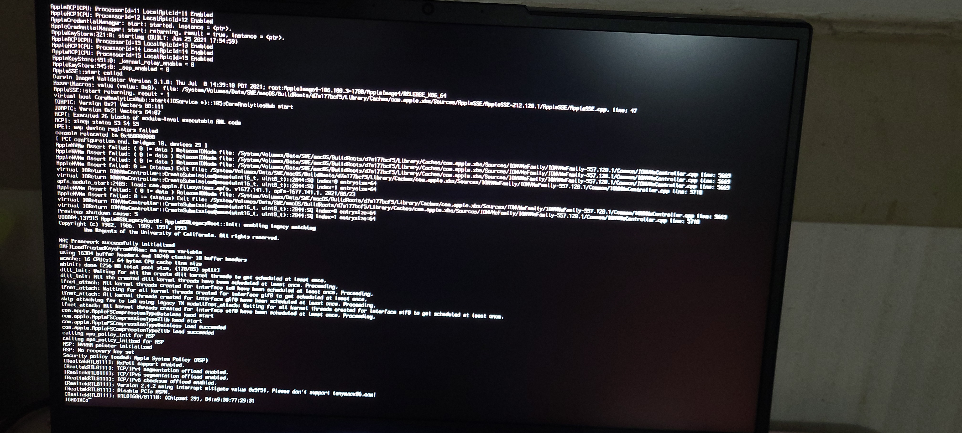

thank you.I use SSDT-Legion Stuck in ACPI Error [PLTF]. It shouldn't work.I use SSDT-5800HX Stuck in Old place is Kernel Panic.
But I see AppleACPICPU: ProcessorId=15. Whether it indicates that the CPU has identified successfully.Maybe it's something else.
Maybe there's a TSC problem with CPU core synchronization.

Btw are you able to run Big Sur? Do you get the RX6600M graphics acceleration? Can you do an IOReg dump from it? As for the ProcessorID=15 I think that is an APIC issue.
