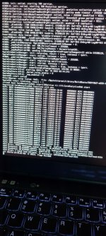

If don't use SSDT-CPUR, ll get stuck in the figure below anyway. Using CPUR will lead to Kernel Panic
2,171
I know but with cpus=1 it’ll book right? I just want to see if there’s a limit to that.

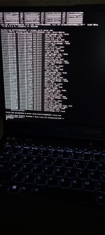

I'm not expecting this to do anything different or work. I've enabled DevirtualiseMmio and built a DEBUG EFI folder. Please use it to try boot and upload the log files afterwards.
This time the results were different
