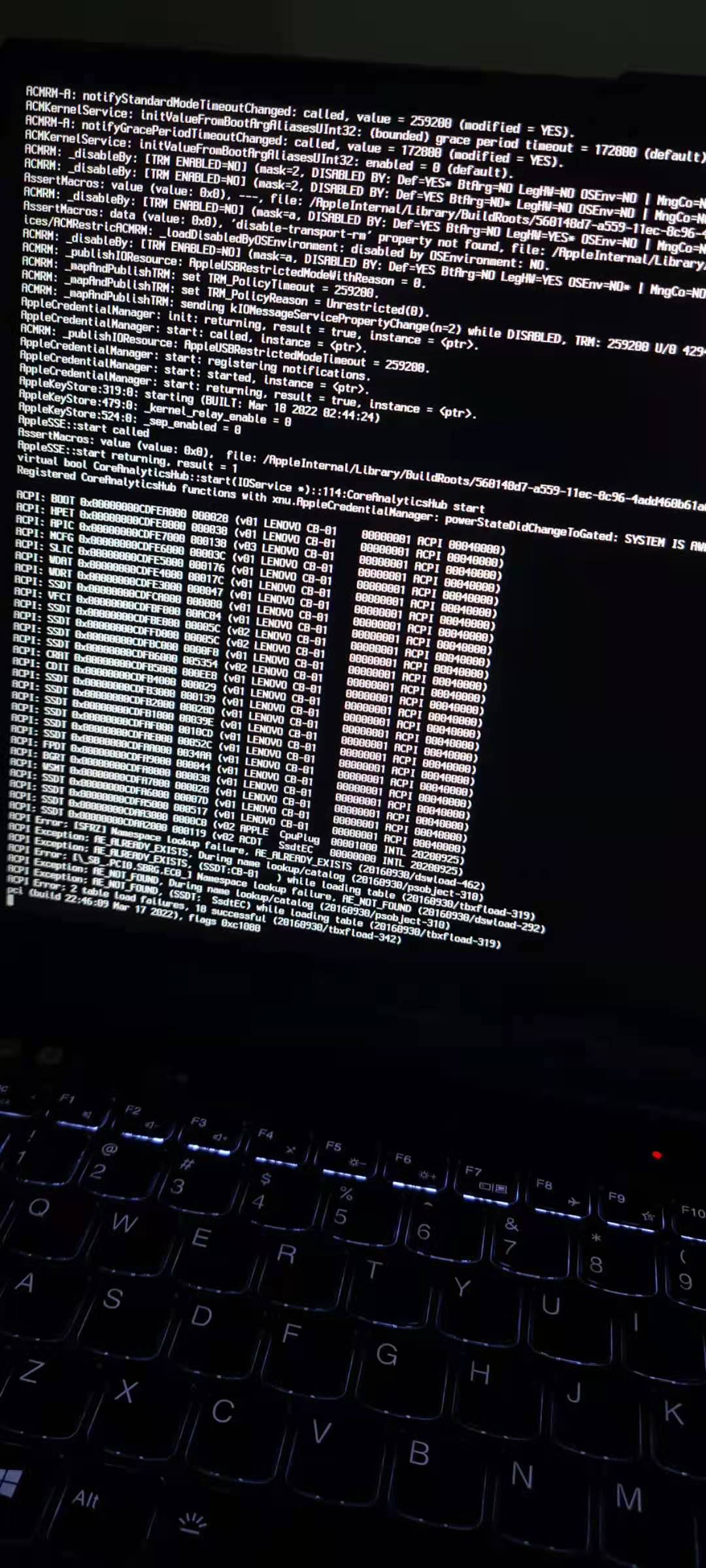

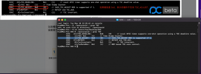

It looks like we have to stop there, tSC_ADJUST is not supported, DSDT has no redundant CPU description,maybe OpenCore will make an analog BIOS module and make the hardware support this function.
I will publish my Monterey installation method and EFI, although there are still many problems. Hopefully, more people will join into improve it, If it succeeds, it could be the most powerful Hackintosh laptop since Apple switched to ARM architecture.
Have you tried old version of cputscsync.kext? In that post a guy in the 16th floor mentioned his pc can boot correctly without support for tsc_adjust. Maybe you can contact him for more details.
2,171
When you boot with cpus=1 can you share the terminal output of sysctl -a hw machdep.cpu.

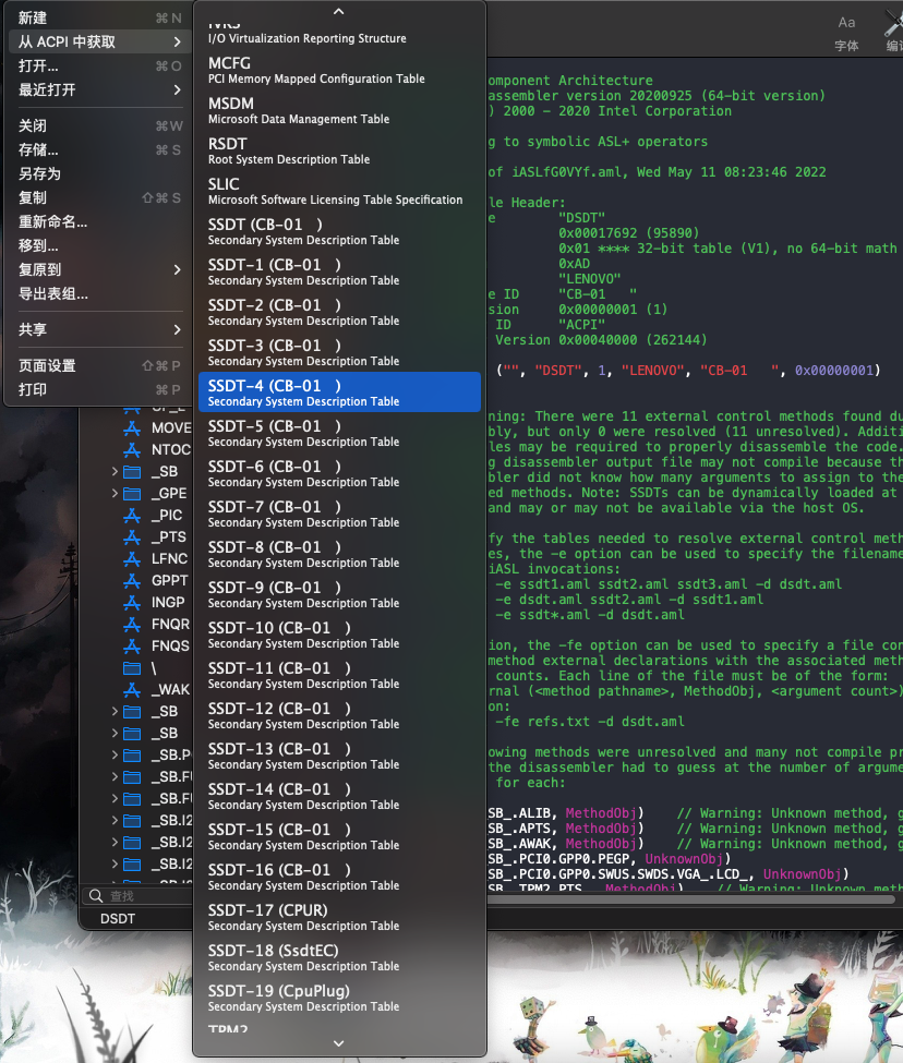

@zxc2689963 Can you boot the system and open MacIASL and go to File -> New from ACPI and select CPUSSDT and send a screenshot please.

2,171
Disable the EC SSDT and try again.
