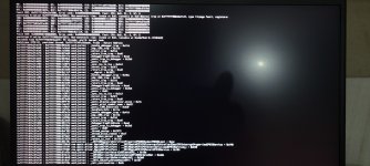

Hi. I want to install Monterey on an AMD laptop (Legion 5 6th Gen with Ryzen 7 5800H and Radeon 6600M GPU). But the installation failed. There is a kernel panic during startup. I don't know what to do. Please help me find out what the problem is. thank you
Brand: Lenovo
Model: Legion 5 6th Gen
CPU: AMD Ryzen 7 5800h
Ram: x2 8GB 3200mhz ddr4
Display: 15.6 1080p 165HZ
This is to install monterey12.3.1
We got stuck on the same spot on Monterey

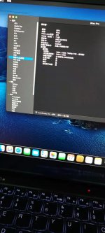

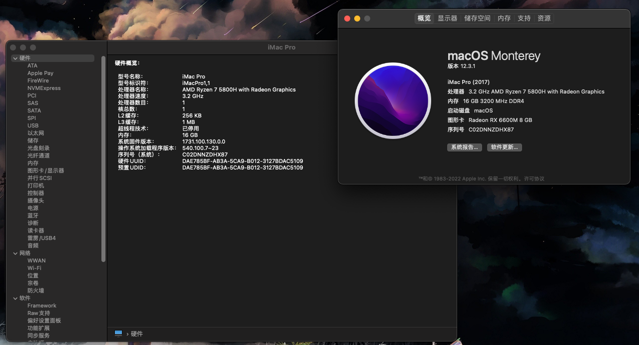

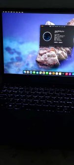

No, I tried 5800H patch and it didn't work.
Added the crucial voodootscSyncamd-16cores.kext, successfully installed and started Big Sur,Tried many way...still can't start the Monterey.
that's a pity
that's a pity
With it successfully running Big Sur, you should maybe do an IOReg dump of your system using IORegExplorer (to see what's been activated). The guys over at the Vega 8 Acceleration thread would certainly be interested. > https://github.com/mvaisakh/Asus-X505ZA-Ryzen-Hackintosh/issues/1
As for the Monterey non-booting issue, when you mentioned the ProcessorID=15 issue, I believe it was an APIC issue. What I meant by this was, it maybe have to be dropped in the ACPI table ie. set to Delete or possibly a value added to ACPI > Patch under Find and Replace. That's something that had affected older chips like Xeons and so they had to be patched that way. This post here best illustrates this method > https://www.tonymacx86.com/threads/xeon-1680-v2-custom-mac-compatibility.281233/page-2
Also mentioned here CPUTscSync is affected under Monterey so some systems have to boot with cpus=1 > https://github.com/acidanthera/bugtracker/issues/1676
