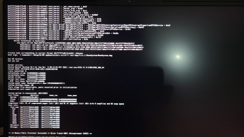

Panic from Monterey 12.6

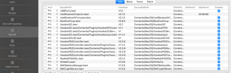

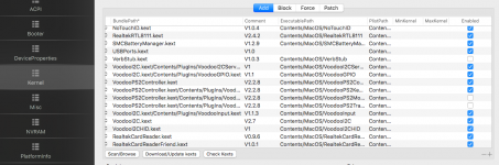

The key (for most) was in the addition of the SSDT-GPIO and the loading placement of the VoodooI2C, VoodooI2CHID and VoodooPS2Controller.
On some setups they may require also a SSDT-I2CElan or a SSDTI2CSynaptics and/or disabling of VoodooInput in either the VoodooI2C stack
or the VoodooPS2Controller stack. Some may even need one of the mouse kexts within VoodooPS2Controller disabled. Let me show you two
examples:
The first is from an Acer laptop, the second one from a HP laptop. If the AMD I2C is not working, perhaps it doesn't have a SSDT-SBUS-MCHC enabled?
As that is the driver for the serial bus.
The question is has anyone else ever bothered to try using my files and technique first before saying it can't be done otherwise? I am not saying there aren't any differences in the AMD architecture vs Intel, but are we that certain that AMD I2Cs really don't work at all using these drivers? And if there are such differences, has anyone sought to find/create a solution for it?

Can you launch successfully every time in big sur? If possible, replace the latest patch with the EFI you are using now and try to start Monterey. I have tried many ways, but I can't guarantee 100% startup. It seems that the success of startup depends on luck. My tests found that this is not a problem with the USB controller. I don't know what prevented the system from starting up. For the touchpad to work, first get rid of GenericUSBXHCI.kext

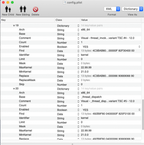

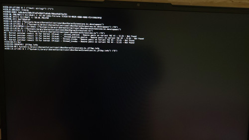

There is a kernel panic when installing macOS Ventura13. Will there be patch support?
You could try setting MaxKernel for the last 5 patches to 22.99.99.

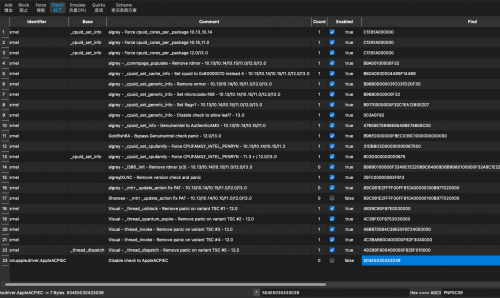

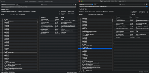

I visited many web pages and found that the problems all pointed to EC, but there were SSDT-EC fake devices. I tried to install High Sierra 10.13, which does not require the name of EC device, and found it stuck in the same place. Maybe the original EC0 device had compatibility problems, and the laptop could not disable it. AppleACPIEC of GA402 is correctly loaded to boot-ec, while Legion 5 is loaded to EC0 but not to boot-ec. If AppleACPIEC is loaded to EC0, the startup may be stuck with a high probability
I have tried the following
Block KEXT, and patch mode to remove PNP0C09, may have done wrong, no effect, is there any way to prevent the AppleACPIEC load, or let him load to the boot-ec
