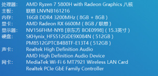

Panic from Monterey 12.6
@ExtremeXT
Please help me
My configuration is a MediaTek network card. The pm8512 is solid. Everything else is the same. I installed the macos on another computer: macOS Monterey 12.6. Do I have problems upgrading to it.
我的配置是联发科网卡,pm8512固态,其他都一样,macos是我在另一台电脑上装好的:macOS Monterey 12.6,我是升级上去的这样会有问题吗。

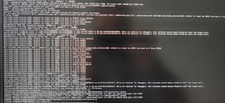

I downloaded your EFI from the main fork on your GitHub... Make a new 12.6 Installer and tried booting off it, I end up at the same place as a couple others.... I get the USBToolBox: XHC0: waitForMatchingService failed or timed out error then after a few minutes it goes to the forbidden symbol. Here are the specs of the machine... Legion 5, (I am able to boot into Big Sur with old EFI), 5800H CPU, Ryzen 6600M, 40GB RAM, 2 XPG Gammix X70 Blade NVME SSDs.
I have tried your main fork EFI unmodified, modified to disable USBXHCI.Kext & change system info, I tried the USB-Fix fork as well with same results.
Has anyone come up with a solution to get past the USBToolBox: XHC0: waitForMatchingService failed or timed out error?

Your SSD is probably unsupported, try disabling NVMeFix or maybe disabling USBToolBox.

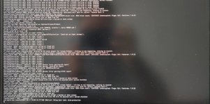

With nvmefix and usbtoolbox disabled, I now hang at the stage below then goes to a forbidden sign....

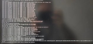

I was having problems installing. So Installed it on a desktop computer. Once installed Monterey successfully I inserted the drive back to the legion and use the EFI posted here and boots right up
except the trackpad and drives hooked to the usb ports. Note. No sound from speakers, but do work under Big sur
Stop at the forbidden sign because there is GenericUSBXHCI.kext, you need to cancel all kext related to USB before you can install it successfully, you need to restart the computer constantly, it will boot into the system successfully one time, and the USB controller will take effect probabilistically. I don't know why, or upgrade to monterey12.6 directly in bigsur.
