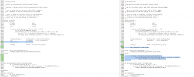

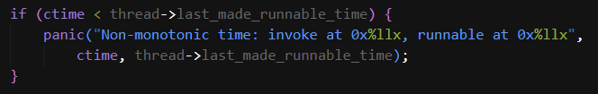

As seen when comparing the Big Sur and Monterey code (Image 2), Big Sur did not check for the monotonic time at this stage. Big Sur only has one monotonic time check (which passes on the laptop as seen when running Big Sur), but Monterey has two more. The order is: NEW_MONTEREY_1 -> NEW_MONTEREY_2 -> OLD_BIG_SUR, the first one added in Monterey passes just fine on the laptop, but the middle one doesn't. We also shouldn't need to worry about the one that also existed in Big Sur, as it should pass just as fine as it did on Big Sur.
My idea is to revert this part of the code back to the one in Big Sur, but for that I need to generate Kernel Patch values which I never did before and I am unsure on how to do so. Maybe someone like @Shaneee can help?
That said, I will try to send a few more testing EFIs that actually fix the TSC syncronization, but I am not sure if I would be successful. The best solution would be to remove the panic anyways.
