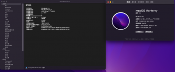

A breakthrough! The patch worked and successfully resolved the kernel panic, thank you guys very much
Hello, glad it worked for you. Can you send a screenshot of About this Mac and an IOReg dump? Also, can you send me the hardware IDs of the USB controllers from Windows? I need it for making an injector kext instead of GenericUSBXHCI. It's outdated and shouldn't be used.
