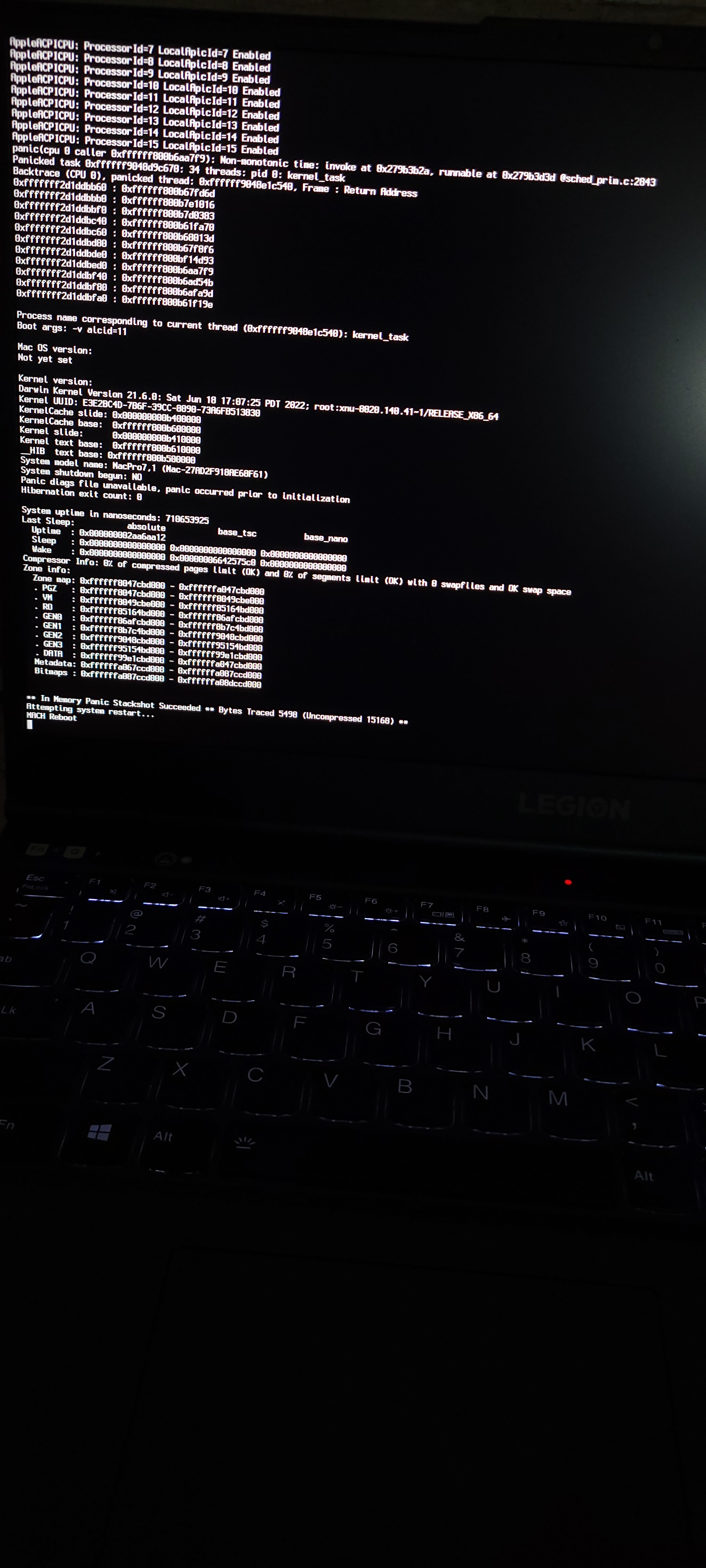

Panic from Monterey 12.6
2,342
The IOReg's are identical regarding the CPU processors etc.
The rename patches didn't change anything in system, not that I can see.
They may have helped with the boot process, but that is unclear.
As the full 8-cores/16-threads were working already in Big Sur, this test tells us very little.
As we know the revised EFI works, can you try booting Monterey and see if it changes anything when booting the newer OS.

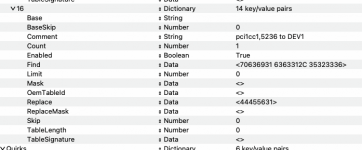

I have added another rename patch to the config.plist attached below. This patch is to rename the second M.2 drive from pci1cc1,5236 to DEV1.
Can you try booting with this config.plist and see if this changes how the second M.2 drive is defined in the IOReg.
Do this before or after trying to run the monterey installer?

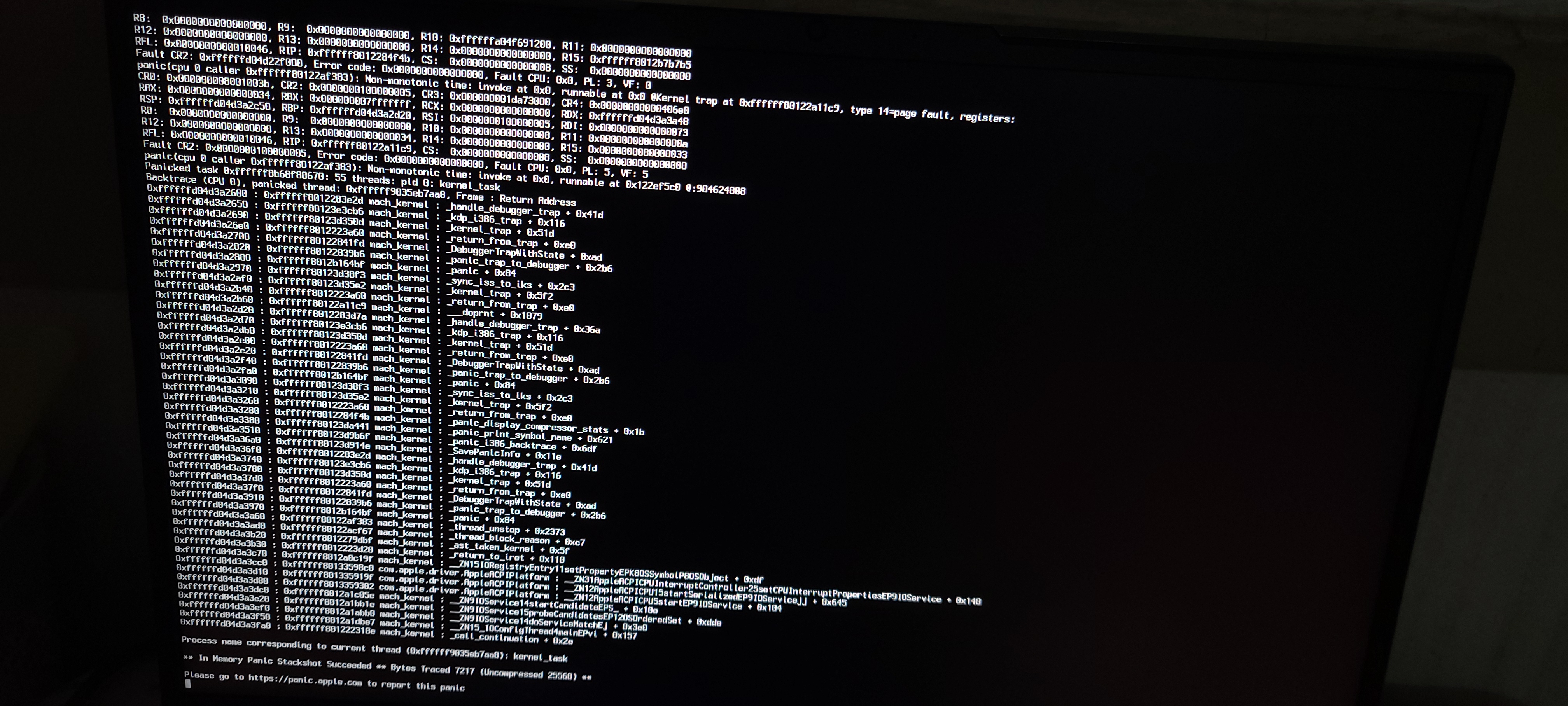

so far the monterey installer is a bust, it reboots when trying to run it from usb and same thing when downloading and upgrading from Big Sur. cannot get any screen info, reboot is too fast. I am going to try with the nvme rename because it seems to tank on the first reboot when it makes a partition for the upgrade.
Trying to boot the new config plist results in an error OC: ACPI Patch 16 is borked, halting on critical error
Borked lol.

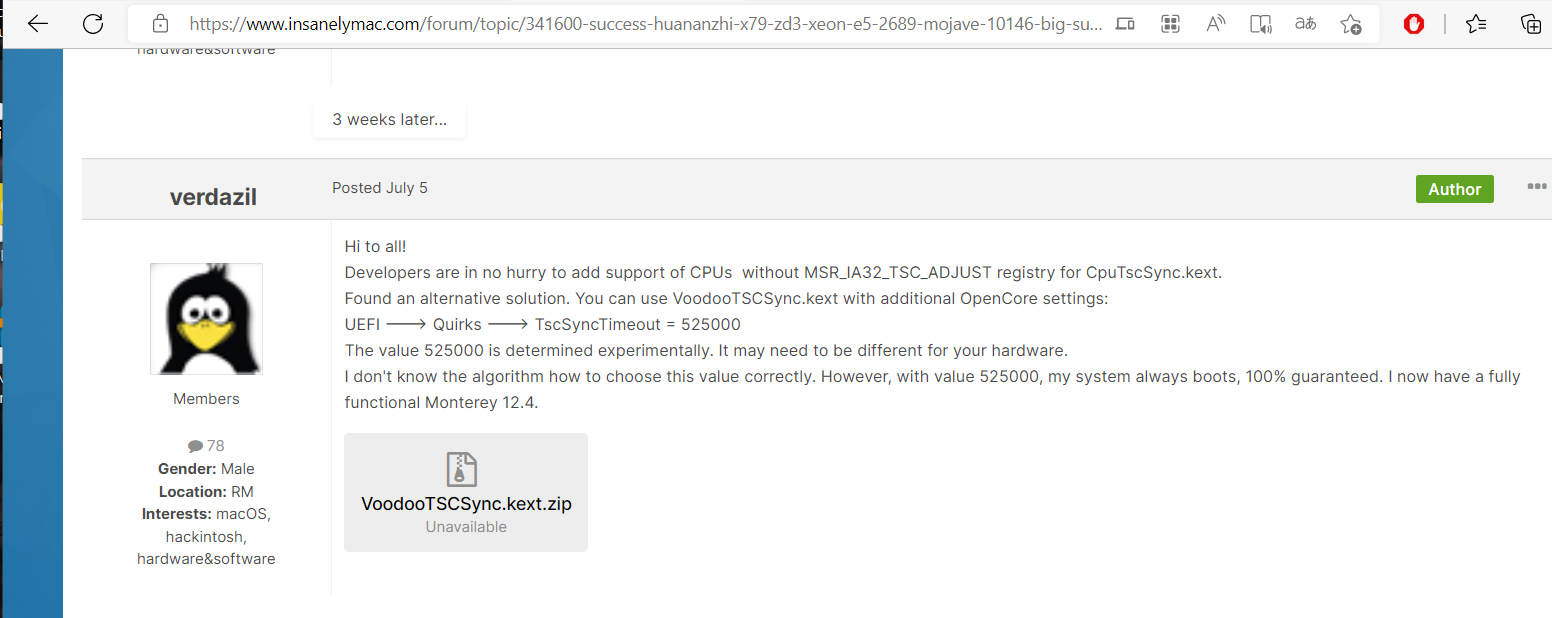

I saw this guy say this way can skip MSR_IA32_TSC_ADJUST. May be different hardware TscSyncTimeout data is not the same, found the whole network did not find the specific setting value, but this can skip AppleACPIPlatform caused by kernel panic, this computer can not install may be really caused by TSC synchronization
Reference:
Have you tried this with the latest opencore build? I am still stuck with no progress myself.
Hi. I want to install Monterey on an AMD laptop (Legion 5 6th Gen with Ryzen 7 5800H and Radeon 6600M GPU). But the installation failed. There is a kernel panic during startup. I don't know what to do. Please help me find out what the problem is. thank you
