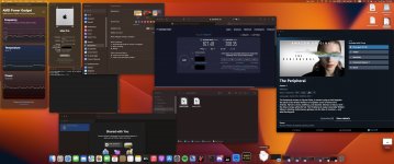

Greetings eveyone,
A while ago I embarked on a journey of getting my ASUS ROG X670E-I (ITX) setup, working with MacOS Big Sur (at first), but since I'm not a "hardcore" tech savvy, I decided to search for information on the web (forums, videos, repositories, etc.) and I'm really glad and thankful I've found this nice community. So without further due, I thank everyone involved for all the hard work and energy in making this possible, specially @CaseySJ and @ExtremeXT.
So, after finding this forum thread/topic, I immediately tried CaseySJ's early (around 60 pages back) EFI and I was lucky enough it worked for me "almost OOTB". OpenCore allowed me to do an offline install of Big Sur and boot into the OS as well. Sadly, I found myself with some caveats due to this board bringing/having an MT7922A WiFi module and I225V not working back then, I didn't have any way to connect OS to the internet because of the lack of options (hardware) I had and the current fixes available now (LAN, WIFI and SOUND).
Finally, after catching up with the information provided here, overly modifying my EFI config and testing over and over, I can finally say I have Ventura 13.0.1 working on my current setup.
Here's the happy result :D:
I also want to point out that (again, due to my lack of expertise) at first, I didn't carefully check the motherboard to make sure if the WiFi module could be replaced or not, so I assumed I couldn't change it, which was a very lazy mistake. So I want to thank @PoMpIs (gracias amigo) for sharing his EFI with me to test it and for sharing pictures of the Hero version and the ITX version of the X670E here where you can clearly see we can swap the WiFi module sitting on the NGFF M.2 slot.
Here are some pictures I took for reference:
I replaced it with an Intel AX210NGW because I wanted to try my luck with the itlwm (OpenIntelWireless) drivers which was suggested by CaseySJ to me and sure thing they worked for my Big Sur (AirportItlwm.kext) and Ventura (itlwm.kext) installs. So far no issues, although I wouldn't know about any special feature, since I don't have Apple devices nearby to test.
I will also attach the ACPI/SSDT files I'm using with this board in case anyone needs them. And if anyone want to check out my current EFI (OpenCore 0.8.7) conf, let me know.
PS: My current build is in my signature.
Thank you! I'll be back for more!

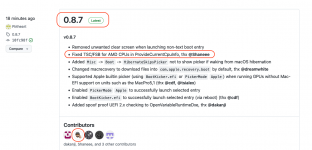

** OpenCore 0.8.7 Officially Released **
