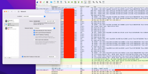

Ethernet packets captured with WireShark confirm that transmitted packets are okay, but received ones are not. Packets are being received, but most likely the driver is looking for them in the wrong place. Will post WireShark screenshot shortly (out to lunch at the moment).
  • These are WireShark capture logs for Ethernet port en1 (my 10Gbps Aquantia)
  • These logs begin as soon as the cable is connected
  • We can see that packets are sent properly, but not received properly
This is the log from standard Monterey 12.6.x driver that does not work. We can see a bunch of packets in white that have arrived, but the packet buffers are filled with zeroes.
And this is from Monterey with the driver from 12.2.x, where everything works properly. We can see that DHCP has responded and normal TCP traffic has begun (in green).

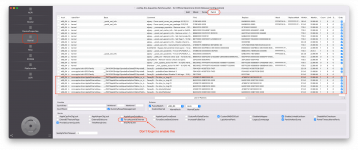

** Aquantia 10Gbps Driver Patches for Non-AppleVTD Systems **
Background:
The AppleEthernetAquantiaAqtion driver in Monterey and Ventura requires AppleVTD, which is not available on AMD platforms. Although we are able to import an older non-VTD version of the driver into Monterey, we are currently unable to do so in Ventura. The driver patches and boot argument presented here enable the native driver in both Monterey and Ventura to function properly in the absence of AppleVTD.
Description of Patches:
Refer to "Aquantia Patch Theory" by clicking here.
Procedure:
  1. Install the six Aquantia driver patches shown below
  2. Add boot argument ixgbe=0 30-Nov: Boot argument is not needed
  3. Enable the kernel quirk ForceAquantiaEthernet
  4. One time action: Perform a cold boot, which means:
    • Shutdown the computer
    • Flip power switch on PSU to OFF for 10 seconds
    • Power back up
If you applied the previous method of injecting an older version of the driver, be sure to undo those settings:
  • Uncheck or remove the injection of AppleEthernetAquantiaAqtion.kext from Kernel --> Add
  • Uncheck or remove the blockage of AppleEthernetAquantiaAqtion from Kernel --> Block
