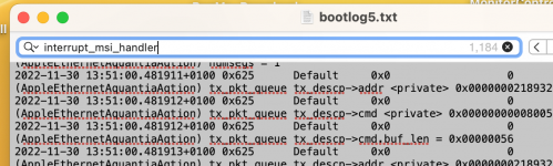

bootlog.txt always the same here
dmesg output could be useful?

1184 instances now :)
upload the txt? or I have to search something here?

By the way, your system log is showing very promising results so if we can fix the patch, the port should work...
Bash:
# Packet 2
<== AppleEthernetAquantiaAqtion::interrupt_msi_handler
==> AppleEthernetAquantiaAqtion::interrupt_msi_handler index=0
==> AppleEthernetAquantiaAqtion::rx_pkt_queue
==> AppleEthernetAquantiaAqtion::allocate_mbuf
<== AppleEthernetAquantiaAqtion::allocate_mbuf mbuf=<private>
reg_put32(<private>, 0x00000002)
Flushing input queue.
<== AppleEthernetAquantiaAqtion::rx_pkt_queue
reg_put32(<private>, 0x00000001)
# Packet 3
reg_put32(<private>, 0x00000003)
# Packet 4
reg_put32(<private>, 0x00000004)

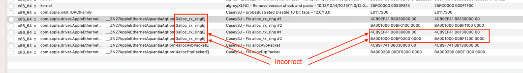

@CaseySJ maybe is it for this?
Problem Found:

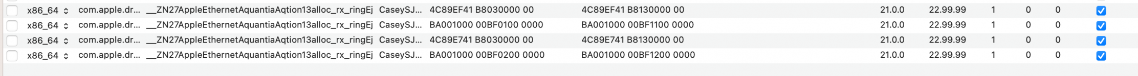

Patches 3 and 4 are actually for tx ring (not rx ring). I have re-listed them here:
Patch 3: Transmit Ring Patch 1
  • Arch: x86_64
  • Identifier: com.apple.driver.AppleEthernetAquantiaAqtion
  • Base: __ZN27AppleEthernetAquantiaAqtion13alloc_tx_ringEj
  • Comment: CaseySJ - Fix alloc_tx_ring #1
  • Find: 4C89E741 B8030000 00
  • Replace: 4C89E741 B8130000 00
  • MinKernel: 21.0.0
  • MaxKernel: 22.99.99
  • Count: 1
  • Enabled: True
Patch 4: Transmit Ring Patch 2
  • Arch: x86_64
  • Comment: CaseySJ - Fix alloc_tx_ring #2
  • Find: BA001000 00BF0200 0000
  • Replace: BA001000 00BF1200 0000
  • MinKernel: 21.0.0
  • Count: 1
  • Enabled: True
Reactions: agent2 and etorix

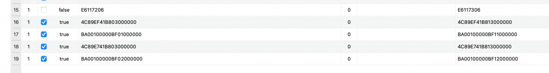

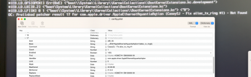

@CaseySJ a correct ip is now there but system does not surf internet
first find patch is not found in my log as before
Let me send you modified config.plist in Private Message...

@CaseySJ your config did the job
first boot it reboots after few verbose lines
then it starts correctly and Aquantia is working well
Tested a cycle of Sleep/wake
It works perfectly (as before in my system)
So now, in MSI trx40 Pro work two internal i211 lan with new kext of @mbarbierato dev and Aquantia PCIE card with your patches :) :)
