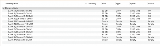

@PoMpIs to avoid memory error you have to map your dimm in your config plist
And if you have a working nvram
After first boot after the memory configuration in plist error will disappear
But true it is only cosmetic

To me without RestrictEvents I get this at the beginning...
making a premise that in the end it's just a matter of taste,
@PoMpIs
if you want to try you can enable custom memory in your config plist PlatformInfo section and try
Having only two Dimm inserted you have to find the right combination for you (possibly without using dummy 1 MB dimm virtual slot
I attach screenshots and the plist of how I configured mine
If you manage to configure yours well, on the first reboot you will still get the popup with the "misconfigured" memories error message, from the second reboot if your NVRAM works from the second reboot you won't get the message anymore
Maybe it's too much flutter for this cosmetic thing..but if you want to try :)
