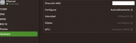

@CaseySJ
If I don't manually set it to 1Gbps, the i225v always connects to 100Mbps. Does the same thing happen to you?
