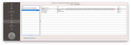

Can you try with the debug=0x12a boot arg too?
All of these captures were done with debug=0x12a as shown in screenshot #2 of this post above.
The full list of boot args is shown here. These were all in effect when previous two captures were done.
Does it still log with serial=5 or does it need serial=3?

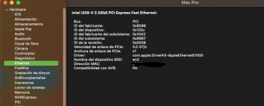

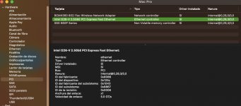

Guys, I don't want to bother you, but it is so that you know that in the new Raptor Lake and an asus z790F gaming there is no problem with the audio nor with the PCIe, everything works... it only changes the integrated network on the board that is an i226v , and OOTB doesn't work, but I guess with Intelmausi it should work..
EDIT: Correct, the intel i226v also works OOTB, it had e1000=0 and that's why it didn't load it, it's perfect
Cheers 🤗
