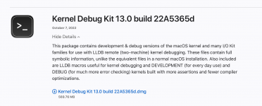

** Ventura Kext Replacement Effort **
Just installed Ventura KDK and attempted to replace IOPCIFamily and AppleACPIPlatform from Big Sur, but the process failed as shown below. However, my Ventura kernel is 22A5373b, but the KDK is for 22A5365d. But I don't think this matters. The real issue below seems to be about further cross-module dependencies.

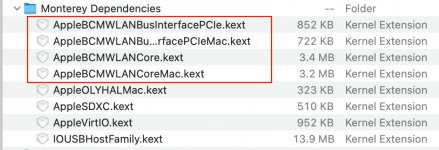

Most of the errors have been resolved after copying these kexts from Monterey:
  • IOUSBHostFamily.kext
  • AppleVirtIO.kext
  • AppleSDXC.kext
  • AppleOLYHALMac
  • AppleBCMWLANBusInterfacePCIeMac.kext
But this one remains:
Error occurred while building a collection:
    1: One or more binaries has an error which prevented linking.  See other errors.
    2: Could not use 'com.apple.driver.AppleBCMWLANBusInterfacePCIeMac' because: Cannot find symbol for metaclass pointed to by '__ZN29AppleBCMWLANPCIeSkywalkPacket10superClassE'.  Expected symbol '__ZN25AppleBCMWLANSkywalkPacket10gMetaClassE' to be defined in another kext
com.apple.driver.AppleBCMWLANBusInterfacePCIeMac specific:
    1: Cannot find symbol for metaclass pointed to by '__ZN29AppleBCMWLANPCIeSkywalkPacket10superClassE'.  Expected symbol '__ZN25AppleBCMWLANSkywalkPacket10gMetaClassE' to be defined in another kext
I've tried replacing all four AppleBCMWLAN* kexts, but the problem remains.
