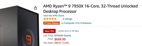

I just thought to notify anyone who's planning to buy the 7950X for their build, Amazon has just shaved almost $100 off the list price!
Was that meant as sarcasm? :)
I will take $500 off my brand new Ryzen 7 7700X and sell it to you for $899 only $399!!
