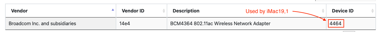

I'm hoping that Fenvi or someone else will produce a compatible Broadcom WiFi/BT module. iMac19,1 has the Broadcom device 0x4464 whereas the Fenvi is 0x43E0.

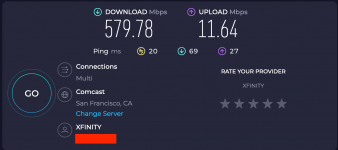

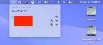

** Intel WiFi with Sonoma **
As others are pointing out, we can indeed use itlwm in combination with HeliPort to use on-board Intel WiFi with Sonoma. At this time there is no Sonoma version of AirportItlwm, hence the need to use just itlwm.
  • Copy itlwm.kext into EFI/OC/Kexts
  • Add an entry in config.plist -> Kernel
  • Download HeliPort and copy it into Applications folder
  • We can keep SIP enabled (csr-active-config 00000000)
  • Reboot
When system starts up, run HeliPort from Applications folder. You should then see a WiFi icon in menu bar. Select your SSID from there.
On my Asus X670E Gene, the on-board Intel WiFi is just as fast as wired Ethernet!

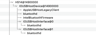

Unfortunately I haven't been able to activate Intel Bluetooth in Sonoma, but Fenvi's Bluetooth works just fine so I continue to have that card installed. In other words, on my Asus X670E Gene the configuration looks like this:
  • On-board Intel WiFi/BT module --> only WiFi is activated (itlwm)
  • Fenvi FV-T919 in the short PCIe slot --> only Bluetooth is activated
Update: Latest commit of BlueToolFixup (from BrcmPatchRAM) enables Intel Bluetooth in Sonoma.

Have you tried upgrading BlueToolFixup to latest commit?
1,272
I just saw @Lorys89's update for Sonoma that was committed yesterday. Will download and try it...
UPDATE: It works!!
