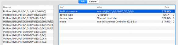

Looks like according to the above address the settings should be this:
and the PCIRoot path is this -
PciRoot(0x0)/Pci(0x2,0x1)/Pci(0x0,0x0)/Pci(0x8,0x0)/Pci(0x0,0x0)/Pci(0x5,0x0)/Pci(0x0,0x0)
I am using F2158680 because that should be the one to use. F315 is for a secondary LAN port only.
I also tried that config, it didn't work
That's a typo, right? Should be device-id for the first one instead of device-type. Also, why F2158680? It should be F2150000
Not typo error. Because that’s the device values I used to set mine for I-225V LAN under Monterey (without extra drivers). Some earlier versions of macOS pre 12 could get away using F2150000 or even F3150000 but not with the setups needed now.
