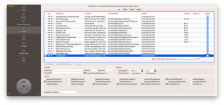

Very good. Now let's disable UTBMap.kext from config.plist, reboot, and post another IORegisryExplorer file.
The previous file is needed, and the new one is also needed.
