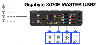

Noch eine Frage mit welchem Programm machen Sie immer die Beschriftung

@CaseySJ Good morning....I checked everything again yesterday and couldn't think clearly anymore :) I have now only used USB2 in USB 2 and only 3 in USB 3 and in 3.2. = USB 3.1 because there was no one else there, I experimented a bit with the Keynote program .... but I think it looks much better and you can understand it better then, I'm curious to see how it goes

@ManuelB
The Keynote version looks good!
However, now we have to repeat the process using a USB 2 device. For example, if you have a USB keyboard, plug that keyboard into every USB Type A port in Columns 2, 3, and 4.
Then connect a USB 2 device into each Type C port. If you have an iPhone or iPad with lightning to USB Type C connector, you can use that. If you do not have any USB 2 devices with Type C connector, I can try to guess the ports or we can disable USB 2 on the Type C ports.
@CaseySJ it is in NZXT H7 Elite
That looks really good!!
We also have to map USB ports on front panel using both (a) USB 3 device and again with (b) USB 2 device. Now you see all the work that goes into setting up a Hackintosh! Yes it takes time, but it’s all worth it in the end.
Reactions: ExtremeXT
In your diagram Column 1, Row 1 is labeled HX00, but I believe this is not the correct port name. The port name is located one level below XH00.

@CaseySJ otherwise just look what would be that here I had HX00 or is it see picture
