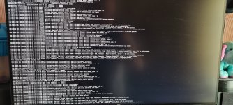

Hello.
My PC
  • MSI MAG B650 TOMAHAWK WIFI
  • Ryzen 9 7900X
  • G.SKILL Flare X5 DDR5 2x16GB (F5-6000J3636F16GX2-FX5)
  • Samsung 980 Pro 2280 PCIe 4.0 x4 NVMe 1TB (MZ-V8P1T0BW)
I use https://github.com/ryanilano/hackintosh-asus-b650ef-amd and boot suspend error bluetooth.
I turned on and off the bluetooth controller does not help.
Tell me how to fix or where to find a solution.
Still, now the moment is only the built-in video card, isn't that the problem?
I want to buy RX 6600.

Hello.
My PC
  • Ryzen 9 7900X
Yes, lack of a compatible graphics card is going to be an issue. There is some development for AMD iGPUs but its currently only for Ryzen 5xxx series and older CPUs. Get yourself that RX6600

Just because you can't see the error doesn't mean that the problem. There could be more but without it completing the OS loading cycle there is no way to know.

That is true, you have to disable the AMD iGPU to have it work with a supported AMD card, the iGPU by itself just will not work. Keep reading that section for clarification.
"And since these GPUs have no drivers even outside of Apple, we need some way to stop the unsupported GPU from being recognized in macOS. See the Disabling GPUs (opens new window)guide for more info on this."

Here a person starts with an iGPU - https://forum.amd-osx.com/threads/a...0-x670e-b650-and-b650e-boards.4160/post-28863
You misunderstand and it could be due to language differences. I'm not sure I can explain it better but will give it one more try so as to try and save you frustration.
He says in the post you linked it booted, just like yours does, but he never says it worked. When he added the 6600XT dGPU it stopped booting at all as I mentioned in my last post. The fix was to disable the iGPU either through an SSDT or bios.
Trust me that if it worked that would be huge news and there would be lots of examples of it on multiple sites, not just here. iGPUs on AMD have never worked until very recently and then only the older generation chips are supported and with caveats. iGPUs on Intel platforms suffer the same fate after 9th generation CPUs because Apple didn't use those chips and so never wrote drivers. 11th generation with device ID spoofing in some instances can function but without graphics acceleration, the display is laggy and very limited in definition and so not recommended.
You system will boot but when the OS goes to load there are no drivers for iGPU so display functionality ends with a black screen. There is no fix, and one is not anticipated soon.

Yes, I took his EFI macOS installed, but after starting the black screen (
Put Sapphire PCI-Ex Radeon RX 6600 Pulse 8GB integrated graphics turned off.
It got worse, after selecting the install icon, the monitor turns off after a short time.
Tell me where to look for the problem.
my EFI with log
You need the agdpmod=pikera boot argument added. This EFI has that enabled

I do not understand, I was correct that the argument (agdpmod=pikera) was. Maybe the wrong EFI was flooded or it was not copied to the flash drive.
Thanks, I will check
