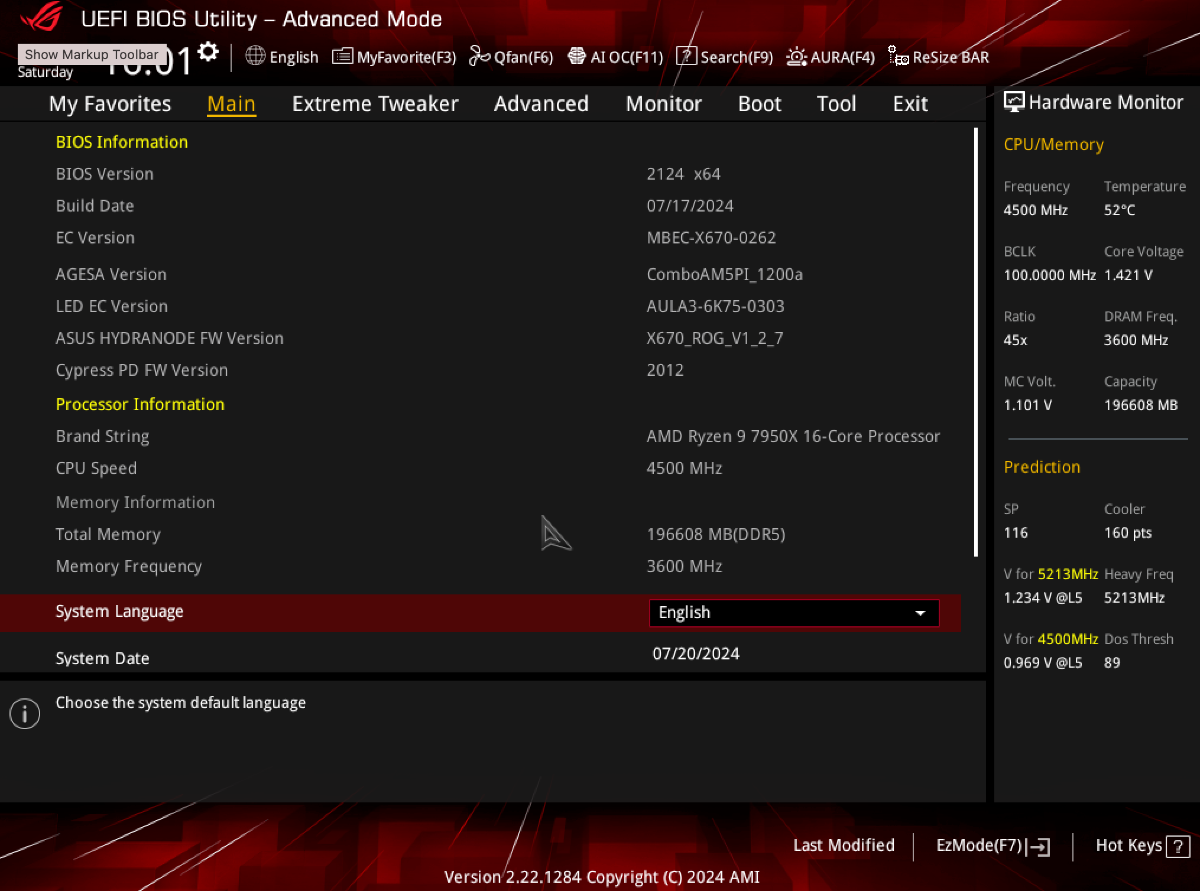

X670E GENE (Sequoia beta 8 ) BIOS up from 2204 to 2308 without any changes
@fabiosun,
Does this mean that the 3 ACPI patches provided by CorpNewt will allow macOS to boot on any of the new BIOS versions? 2204 and 2308 and others?
Or are these ACPI patches specific to a particular motherboard model?
Are they for Asus motherboards only?
@CaseySJ they are specific for motherboards
Asus motherboard could have some ACPI patches similar or rhe same
Reactions: CaseySJ
