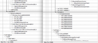

The one on the left is lev12345's and the right is from my B550 Vision D. This line is showing the XHC allocation. You'll notice on the right there's a key called driver-child-bundle and it directly refers to Apple's USBCHXCIPCI driver. It's not present in the left one.
More comparisons - here GenericUSBXHCI is doing the allocation. On mine I don't have this since I don't use it.
On lev12345's here under GPP0 nothing has been allocated - but has on my one. However it has somehow gone to GP18 on his.

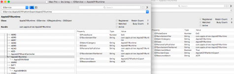

Next there's AppleEFIRuntime. Here everything is the same except on my one is shows IOMatchedAtBoot is True.
