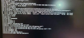

I can try to install Big Sur, since the installer also works with your patches without the cpus=1 signature, but the installer and the monterey system do not want to start, there is a new problem with these patches, see the photo.
But I also removed the cpus=1 argument
2,171
Interesting... So those patches allow the installer to boot without cpus=1 but not the installed system. I'll look over them and verify later on.

it works with big sur, but it also doesn’t want to work with monterey, photo when loading the monterey installer

2,171
That’s great. So the issue with Monterey there is GPU related. Try adding the boot arg -radvesa for the Monterey installer.
