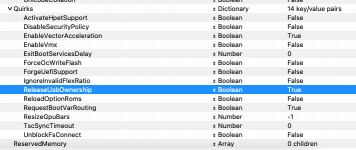

There is an entry at the bottom of the config.plist - UEFI > Quirks > ReleaseUSBOwnership, which is set as Enabled/True. This could be toggled to Disabled/False to see if that helps with your USB ports.
Screenshot 2022-08-09 at 15.39.17.png UEFI > Quirks > ReleaseUSBOwnership

Hi Ed, That seems to have worked, all the ports on the rear are working but they don't show up in Hackintool
2,348
Good to hear that.
Hackintool is primarily Intel focused, with some Fresco Logic and ASMedia ports showing. Most old AMD USB chipset ports don't show in Hackintool, until a USB configuration has been created.
I tried mapping the USB ports on my FX system with Hackintool, it wasn't fun and didn't work.
USBMap is better option for old AMD systems, but even that has its limitations.
IORegistryExplorer shows the ports when a USB device is connected, even if Hackintool doesn't. This is a more cumbersome way to discover the USB ports, but it works. I tried creating a USBMap.kext, the process was fine, the kext wasn't, even with the correct connector type set for each port.
