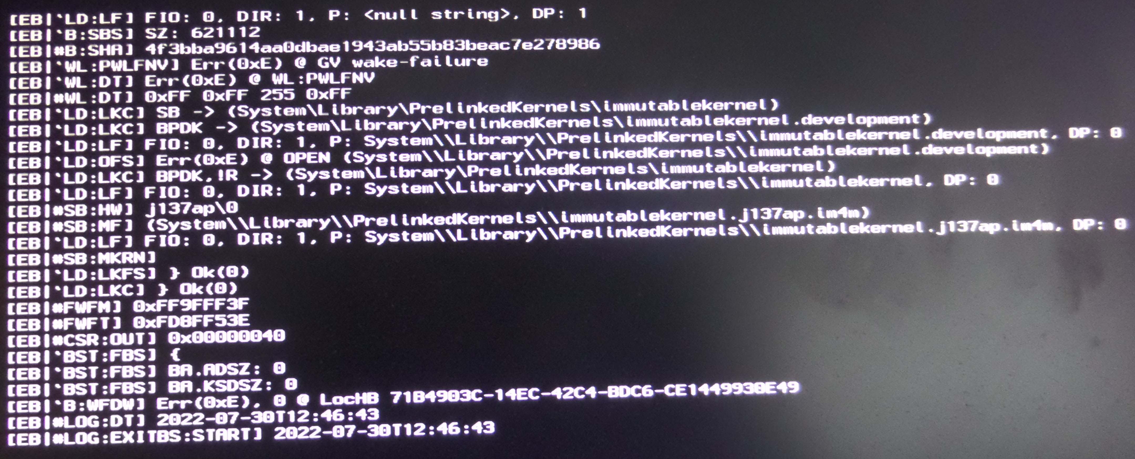

HI ED, just tried that EFI and I get stuck on [EB #LOG:LOG:EXITBS ; START] 2022-07-27T19:14:41
So im Stil stuck on the line [EB #LOG:LOG:EXITBS ; START] I've looked at the dortania troubleshooting guide and I cant see anything wrong in the config.plist. I haven't changed anything in the EFI as mentioned, here's a screenshot
I will have a look at this later when I am on my Hack. There are a number of issues that can cause this KP, we just need to work out which one is the cause and edit the setup accordingly.
