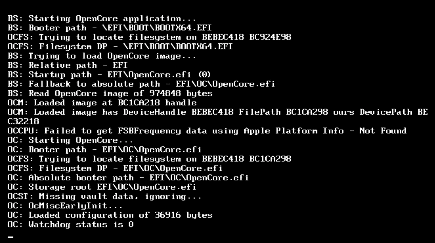

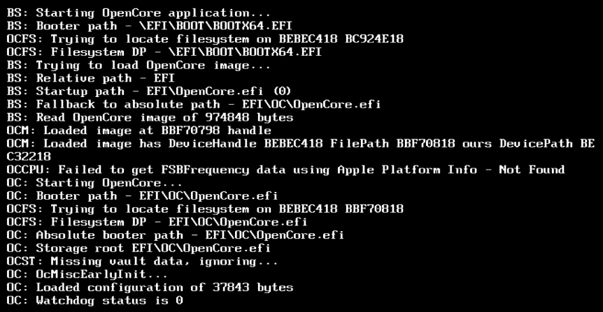

So I tried the Debug EFI even though I've never used it before and on booting the system up I get this text as seen in the ScreenShot....
Does anyone make any sense of it as im stuck..

Try this EFI I have made the following changes:
  • Replaced SSDT-EC-USBX-AMD.aml with SSDT-EC.aml & SSDT-USBX.aml
  • Removed GenericUSBXHCI.kext
  • Changed config.plist to match above changes.
  • Set DisableWatchdog quirk as True.
  • Checked the rest of the config.plist, all seems to be correct for an FX AMD system.
You just need to add your Serial Number etc to the config before you use it.
Hi, just tried your new EFI and still stuck on what looks like the Debug screen..
I made a mistake, I forgot to replace the Debug files with the ones from the Release version. Once I replaced the files I get the black screen again.
