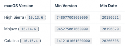

Here is an OpenCore EFI created using OC 0.8.1 that I use for my FX8350/Asus Sabertooth system. The Serial Number etc, have been removed from the PlatformInfo section, but the rest is as I use it on my old FX system.
Use this EFI as a base for setting/creating your own EFI folder.
You will need to to add the UEFI > APFS > MinDate and MinKernel entries to the config.plist so it works with Catalina. As the current entries are set for running Big Sur or Monterey.

Im trying to install Catalina 10.15.7 so is the Min Date and Min Version different? Should I try 10.15.4 instead
910
No, Catalina only has the one setting for those two entries so changing the version won't make any difference.
